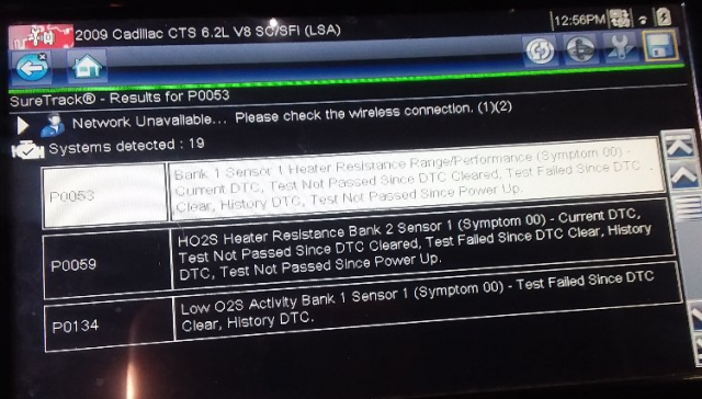

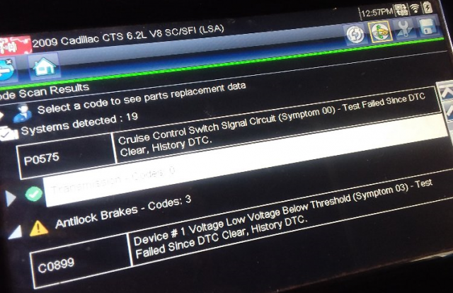

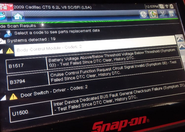

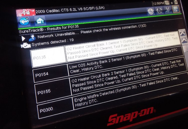

  2. Engine light is on (tuning) and there is ~15 codes - See attached pictures:
    1. Anything high risk?
    2. Should I take the car to any local shop specializing in tuning to run some diagnostics and clean codes.

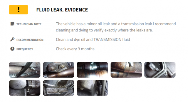

  3. Inspection showed very light engine and transmission leaks (there is nothing on the floor when parked). You can see some light oil under the engine and transmission fluid on front side near driveshaft. - see attached.
    1. Can I drive this and do nothing and just assume I need to do oil and transmition fluid refills and watch it?
    2. Or should I try to fix those, but I am not sure where to start and I do not want to be sold on high expenses by shop.

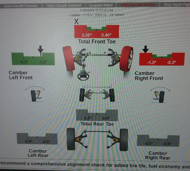

  4. TECHNICIAN NOTE from my inspection at my local shop: “While sitting at idle the vehicle has an intermittent misfire feel to it. While driving straight the steering wheel was a tad off to the left”.
    1. They checked alignment and it failed when measured – so doing alignment I assume may address “left”
    2. Any suggestions what can drive misfire at idle and can this be related with engine light , tuning set up and/or 15 open codes
